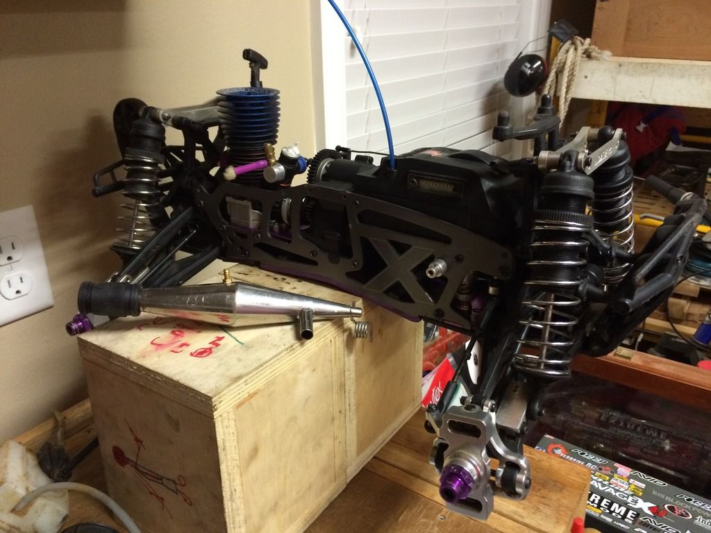

Time for a little tlc after many years of abuse and me going through the nitro learning curve. Just thought I would post some before and after pictures.
I plan on replacing all the bearings, rebuilding the diffs, obviously a good cleaning and probably some new dirt bonz. I love the badlands but like to change things up every now and then. Who knows what else, maybe a new body also.

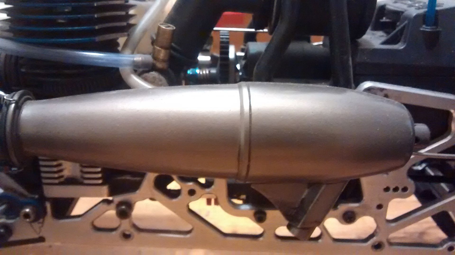

No jokes I clean my Dynamite Hard Anodized O86 header and pipe with sand paper. Seriously, turns out sweet and the HD coating is so hard the sand paper does not scratch the pipe..
Your looking at a pipe over 5 years old I bought used, pics taken a week or so ago

Everything has been disassembled and cleaned. It's about as clean as I can get it. I love those videos on how to clean your rc and the vehicle isn't that dirty to start with and they brush it with a paint brush and then blow some air on it. Voila it's clean.  Well let's just say that wouldn't work on mine. There was dirt and grease etc., everywhere.
When I rebuilt the diffs I decided to finally switch to oil. The other times I rebuilt them I kept going with the grease. This time I went with 30k up front and 10k in the rear. Whether or not there is a performance difference I don't know but it will now be much easier to change oils and or rebuild the diffs.
I have been changing bearings as I go and they have really made a difference with how smooth things are. Especially in the transmission. However after changing the wheel bearings I couldn't tell any difference by spinning the wheel nut. The old wheel bearings still felt pretty smooth after removing them. After four or five years there is hardly any grit in them which surprises me.
Still deciding on a body. The past couple have been a proline f650 and I still like that but I am also considering an older ford body. Maybe going the rat rod look but my painting skills are pretty limited.

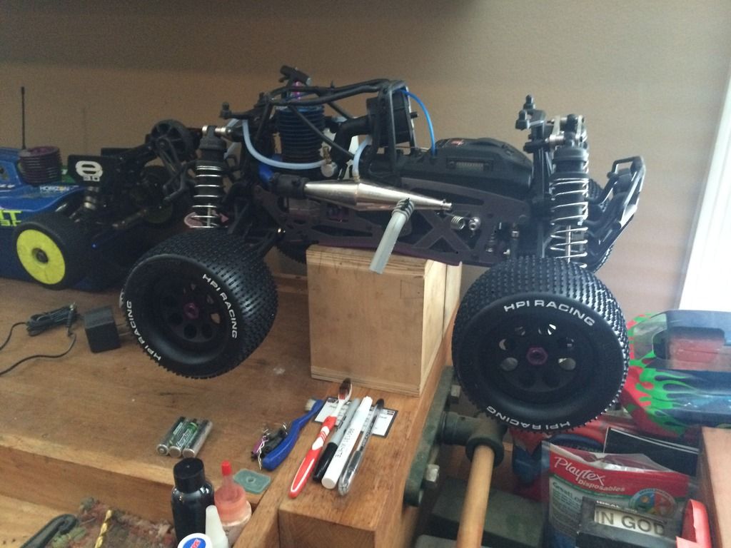

Post by badboy » Fri Nov 27, 2015 8:55 pm
Started putting things back together and I think I am going to find time to do maintenance in the future. I haven't purchased a crock pot yet but after running my buggy today and noticing it's pipe and manifold need cleaning I think I will soon.
Post by badboy » Sat Dec 26, 2015 7:58 pm
Finally got everything cleaned and put back together. New fuel tank, tires, wheels, bearings, clutch shoes and springs and probably a few other things I am probably forgetting. Most importantly it's clean inside and out which I am sure is going to improve everything.
I think I am going to stay up on the maintenance instead of letting it get that bad again.
