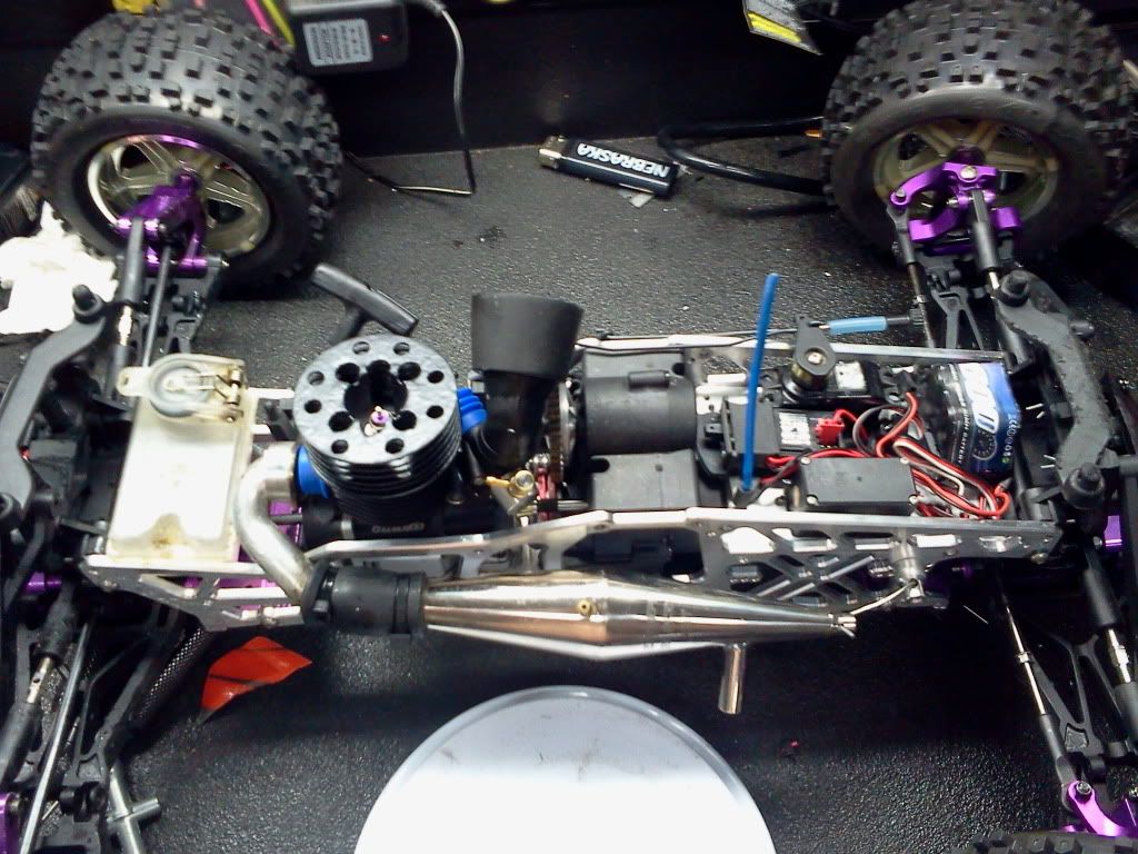

Post by nitronly » Sat Dec 15, 2012 9:53 am
It looks like you modded the rear skid? Kinda hard to see in the pic. The flm plate is lighter than the stock radio box? Whats your battery and rx in?
Post by sunshine » Sat Dec 15, 2012 10:10 am
as far as plate verse empty box the plate wirh 1 cross brace is half the weight and the steering servo mounted in plate the throttle has to have side mounts and the battery , hump back is Velcro'd in and the tx is still on the switch plate just modded to fit between the servos, i might make a cf lid but not sure i need it due to the fact im not jumping or bashing well i hope not LOL
Post by nitronly » Sat Dec 15, 2012 10:53 am
What about the rear skid? I was planning a similar set up using a prc servo plate but it was one of the parts I waited a year for and gave up on. The prc plate is the exact same just made from cf. I might try to cut one from this but it is pricy or I might mount everything with no plate at all, just mount everything to the chassis some how.

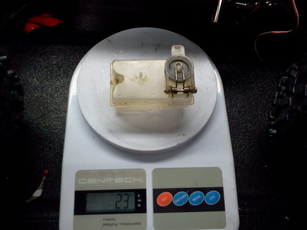

Post by sunshine » Sat Dec 15, 2012 11:18 am
Image  stock tank weight
Post by sunshine » Sat Dec 15, 2012 11:20 am
Image this tank is more than half the weight and will hold less fuel weight , which is fine dont need allot of fuel to do a pass or two .

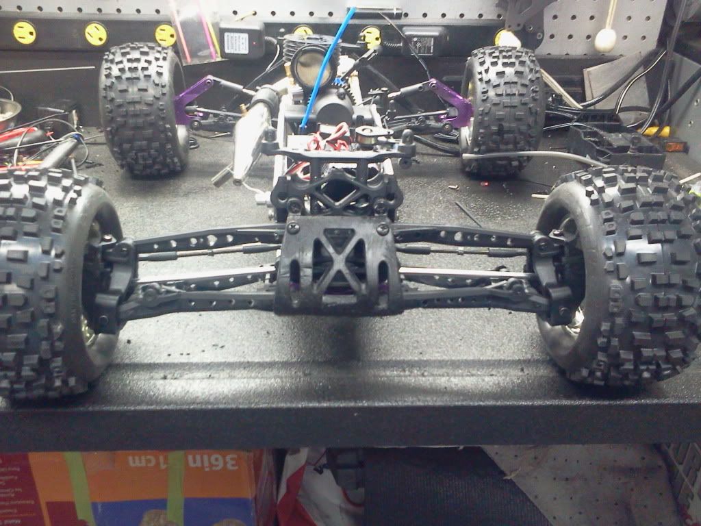

Post by sunshine » Sat Dec 15, 2012 3:49 pm
Image   been workin on LL this mornin tryn to loose more weight ,, as you can see no shocks or upper arms holding the front up ,, any one take a guess how i did it ?
Post by sunshine » Sat Dec 15, 2012 3:51 pm
Hint, its lighter than two upper arms .......

Looks like a little sway bar action, very nice looking truck btw.

Post by Cadimman » Sat Dec 15, 2012 6:57 pm
[quote="sunshine";p="855344"]Hint, its lighter than two upper arms .......[/quote]
Reverse droop screws.
Post by sunshine » Sat Dec 15, 2012 8:04 pm
nope,,, 2nd clue,,, it is made with carbon fiber and brass square tubing , no screws .

I was thinking of cutting the center out the lower arms too. Pretty extreme what you did drilling all the holes but it should hold up for speed passes. What you got going on with your skids?

Yes Nitronly i think the Swiss cheese affect will save weight and be strong enough for speed runs ,,,, as far as the skids i removed all the bumper parts even the braces and heated the front lower near the bottom with torch so it would bend back into the diff bulk head and screwed it then heated some more so it would not have any tension on the screws worked great and it holds the upper and lower a-arm pins in ,,, i dont plan on hitting anything so no need for a bumper ,,,,,,,,,
