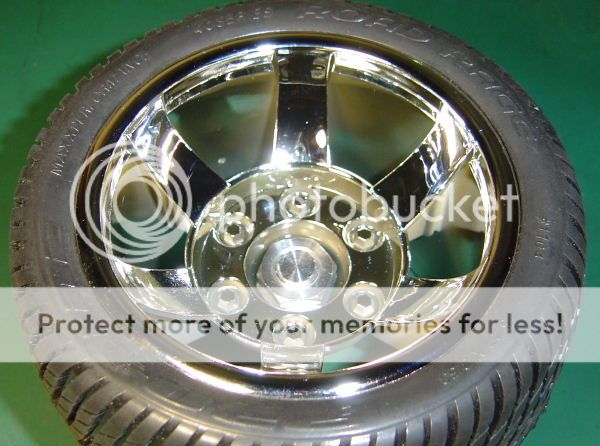

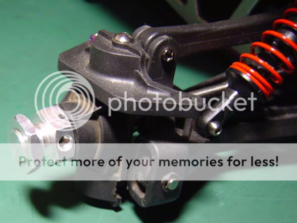

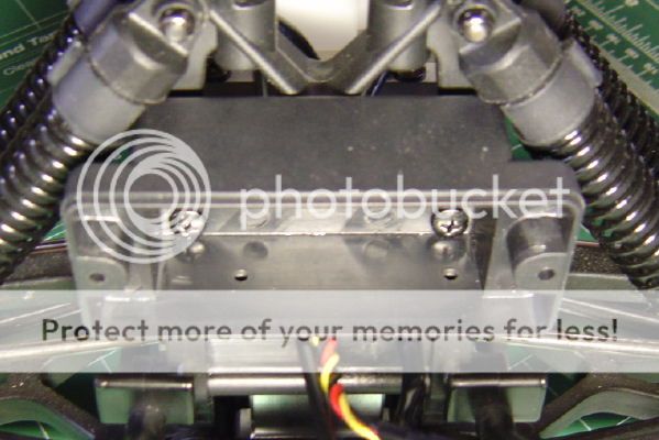

                          40 series Road Rage mounted on Thunder Quake wheels
                              To help prevent ballooning the tires have been fishing line'd.
                              I have heard this suggested before and wanted to try it since taping the inside of the tires does not appeal to me.
                              80 lb Spiderwire is wrapped 5 times and tied off just snug around each of the two center grooves.
                                  19mm drive hubs are also from the Thunder Quake
                                  They are modified in much the same way as the Ofna 17mm hubs.

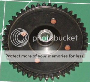

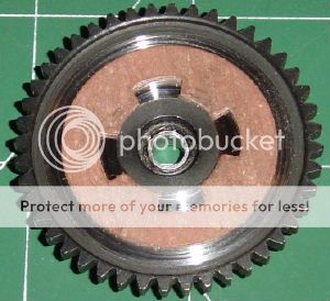

                                      Modified Hot Bodies 44 tooth steel spur

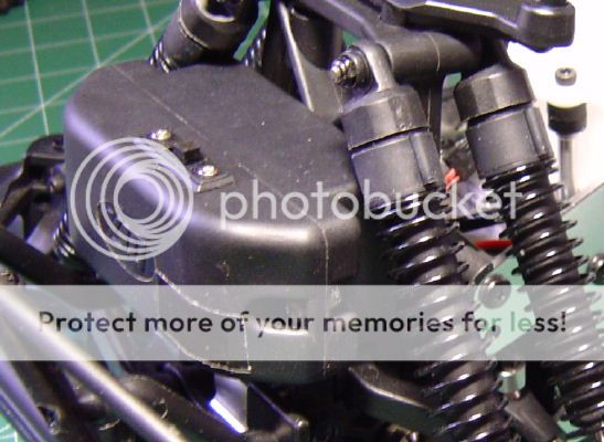

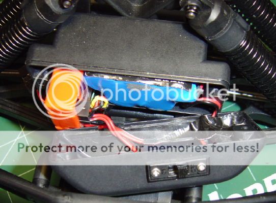

                                              Please Note:the radio box pics are from the SS 4.6
                                            The radio box will be from a Duratrax Firehammer
                                              Switch,batt,and reciever fit nicely inside and mounts with the two upper shock tower screws.
