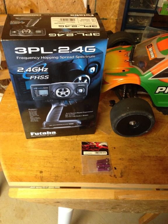

Post by LLkoolskillet » Thu Apr 11, 2013 6:43 pm
Got some goodies today, I've read nothing but great reviews about this radio and the range is over 1000' I also picked it up for $104 shipped. The rod ends are to help eliminate the slop in the steering. Even with a modified GH bell crank and the new flux tie rods, a few cartwheels at 70mph will trash anything. So I'm going to put all metal everything on the steering, I also have some GH hubs that will be going on as well. I'm not worried about scrapping anymore weight and in fact I've added a half pound since I broke into the 70's. I hav no issues breaking 70 consistently and even locked in 3rd ;). So by adding more metal I hope to take out the slop, at least for a few runs lol

Post by bigblockRI » Thu Apr 11, 2013 9:07 pm
3pl ftw... im gonna save the 40 id spend on the flysky and drop it on one of these.. maybe even the 4pl or whatever the next one up is. whats the part number on those rod ends.. i need to scoop some myself. So all GH stuff in the steering besides the tie rods from the flux will make a big improvment over the sloppy stocker correct? Mines sloppier than a 2$ lady of the evening.

Post by LLkoolskillet » Thu Apr 11, 2013 10:58 pm
Oh I'm still ditching the flux tie rods to. I have some Lunsford TI rods I'm going to try and fit on the GH ends. I really hope it removes the slop cause I could litterally see the wheels fighting each other going down the road. I'm loosing some hard earned mph right now because of this.
Go to eBay and type in savage tie rod
Post by LLkoolskillet » Fri Apr 12, 2013 3:46 pm
Please note this, if anyone buys the hot racing alloy rod ends they need to buy the set of 8. Why because you can buy a set of four but they are sold in standard pitch and reverse pitch. That's why you need to buy the full set of 8 for $32. I no have to buy this set argh!!!
