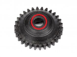

Well turns out heres an easier fix now. HPI Octane gears are hardened steel and work as replacements. Hpi111167 and hpi111169. Pic courtesey of Llcoolskillet.

Since mods are the only ones that can post in the tech tips section, I wanted to put this out there about the octane gears on the XL 3spd.
Do they fit... yes but anyone who does go this route they may want to file or sand the area marked in red just a super tiny bit to make fitting the C clip back on with ease. I got it on but its a hair tight so a quick file and its perfect.
Im still a fan of the original mod using the 2spd gears as they are wider, but this is a direct replacement with virtually zero modification
